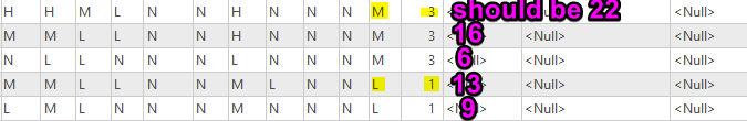

Pulling my hair out here...I'm trying to rebuild a for loop in a field calculator tool in modelbuilder. No matter what I try, the for loop only returns the last value of the iteration. This should be so simple, but I've been stuck for hours! Tried all sorts of reconfigurations.
I have several fields with H,M,L or N values. Each of those should be assigned a score, which is then summed and returned for the new field. No matter what I do, the returned value is caculated ONLY based on the last field in the list as if I had the sum = 0 line inside the For loop...but I don't.
Any ideas?
CalcFVScore([!Field1!,!Field2!,!Field3!,!Field4!])

It runs just fine for me as well, the problem is the solution is wrong. It only returns the result of the last field in the list. If I change the list, the result changes...it's not summing the cumulative values from the for iterations, only the value from the last iteration.
AaronWorthley1
This is what gets returned. If I reduce the number of input fields, whatever is the last one is what gives up the value.

I think it's solved...first I found a domain issue in the geodatabase- the field had both a domain assigned as well as a subtype with domain. Running again I had the same issue, but then I deleted all the fields from the expression, and re-entered them one by one, running each time to see if it worked. After adding them all back it seems to be returning correct results.
I cannot explain it, thanks for taking a look. I did use Dan's version to simplify the code which is a good improvement.
