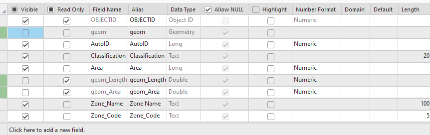

I have coworkers who use QGIS and cannot load classes from the geodatabase (question for another time), so I am attempting to export some of these feature classes as shapefiles. However, whenever I try to export (either by right clicking export or by using geoprocessing tools) I receive the error in the title of this post
 ERROR 002809: Field OID in Zoning is of an unsupported type for the output workspace.
I have been unable to find any way to remedy this issue. Clearly I am unable to delete the ObjectID field which is what I am assuming the error is having an issue with. I am able to export this without issue to other geodatabases, but just not shapefiles. I have this same issue for every feature class within the geodatabase

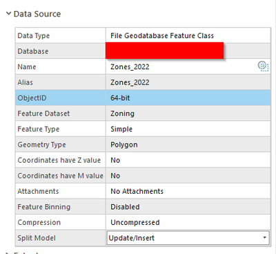

3. Bingo, this was the issue. The ObjectID type is 64 bit (see screenshot) which I believe is because I imported the shapefiles into a new geodatabase created with the latest version of ArcGIS Pro. I was able to replicate this by using the workaround described at the tech support page and quoted below:
In the Options dialog on the Maps and Scenes page, check the box to Use field types that are compatible with ArcGIS Pro 3.1 and earlier releases when adding query layers and text files.
After flipping this option, I selected the original shapefiles, created a new geodatabase, and imported the shapefiles as feature classes into this new geodatabase. In the data source tab, I noticed that the ObjectID Data was now 32bit after I had used the aforementioned workaround. Now, I am able to export feature classes to shapefiles with no problem.
So, if I am understanding correctly, does that mean all new geodatabases are unable to export to shapefiles since they write the ObjectID as 64bit? That seems like a massive change that should be better advertised. I would at least like the option to export as 32bit or have some way to change the 64bit ObjectIDs to 32bit. Now I have a geodatabase full of 64bit ObjectID feature classes that I cannot export to shapefile which is common practice when distributing geodata in my office.

do you perhaps have data types not supported by shapefiles (eg Big Integer, Date Only and a few others)
Geoprocessing considerations for shapefile output—ArcGIS Pro | Documentation
... sort of retired...
user2123456
Hi Dan,
That was one of the first things I checked and I do not any of those data types as a field.

1. Do you have any Joins with the feature class?  Remove those and - " try to export again.
2. Is this an Enterprise GDB?  There is a BUG-000164103 - "In ArcGIS Pro 3.2, the error message, “ERROR 002809: Field OID in <path> is of an unsupported type for the output workspace." is returned when using the Export Table geoprocessing tool to export as a file geodatabase from a non-enterprise geodatabase."  Explanation:  A non-geodatabase database table is used in ArcGIS Pro as a query layer. If that table does not have an ObjectID field (the code sample for creating the table in the database did not specify an ObjectID), the system automatically adds one for use in ArcGIS Pro. This ObjectID field is 64-bit by default. Tables with a 64-bit ObjectID field cannot be exported to legacy formats like dBASE database files, which do not support 64-bit Object IDs or Big Integer fields.  The workaround provided using the option to ensure compatible field types are used allows the table to be added into ArcGIS Pro using a 32-bit ObjectID field, so this table view can then be used as input to export to an output dBASE table. May be related to this Error message you're seeing.
3.  Starting at ArcGIS Pro 3.2, there are 64-bit field types.  These are not compatibable with legacy formats (i.e. shapefiles) that are 32-bit field types.
user2123456
Hi Robert,
1. No I do not have any joins with any feature classes within this geodatabase.
2. This is not an enterprise geodatabase.
