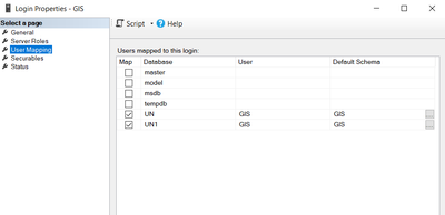

wizgis
Thank you @DiegoMCastellari for sharing the screen shots it does help. Just wanted to confirm few things here to understand your workflow:
  1. How is user/dataowner (MGUN) created ? Using the Created DB user GP tool present in ArcGIS Pro or from SQL Server Management Studio.
  2. Does the user (MGUN) has the following permissions:
    1. Create Table
    2. Create View
    3. Create Procedure
Additionally, in SQL Server Management studio after logging into the instance, navigate to Security > Login > Right click on the login (MGUN) > Properties. In the login properties window click on user mapping and check that the user (MGUN) is correctly mapped to the geodatabase where you wish to create Utility Network and the schema name matches the name of the user. Following screenshot can be used for reference.
Hope this helps.
