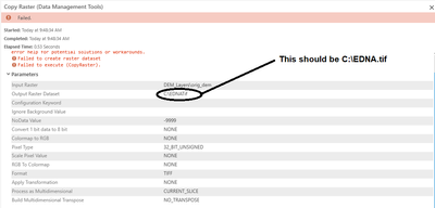

Hi Doug,
I just refer to the attached screenshot and found the error in the second-line output. As suggested by Dan and Jayanta, you should type *.tif.
Please refer to the below screenshot.

I was able to copy the original DEM file to a .tif file and store it on a folder right off my C drive. I also reprojected the layer to a projected coordinate systems and updated the vertical coordinate system to "NADV88" (as referenced in the USGS DEM file metadata). However, now when I attempt to run a geoprocess on the updated .tif the geoprocess errors out the same as before. I tried running a slope process and a Focal Statistics process and both immediately errored out with the same error as before. Interestingly, using the Raster Functions seem to work fine, but the geoprocesses seem to be having a problem for some reason.
ERROR 999999: Something unexpected caused the tool to fail. Contact Esri Technical Support (http://esriurl.com/support) to Report a Bug, and refer to the error help for potential solutions or workarounds.
Failed to execute (FocalStatistics)
