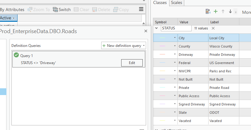

I created a definition query (in this example, "don't include driveways") but driveways still show up in the symbology window. They don't render on the map or show up in the underlying table so that part is working.  Is the symbology pane ignoring the definition query? What am I missing?

This looks like BUG-000097344 - Symbolizing a layer by unique values where the layer has a definition query applied, and the field to be symbolized has a domain applied, returns all values from the domain rather than only the values that satisfy the layer's definition query.  It's in the Product Plan to be fixed.  Just not sure when.

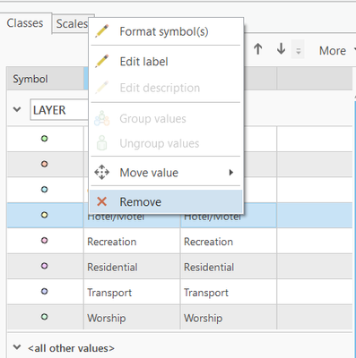

As mentioned by Robert, this is a known bug with ArcGIS Pro.
BUG-000097344
You could just right-click the symbol > Remove (till the bug is fixed)

It looks like the symbology pane does not like my definition queries being based on domains. If I base it on a field without a domain (even within the same FC) it works as expected.

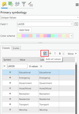

Could you click on "Add all values" icon in symbology pane, and check if the values refresh to exclude the driveways?
Think Location
TychoGranville
I did "add all values" to refresh it, no change.
BUG-000097344
