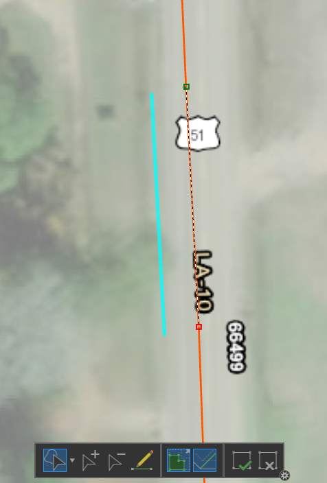

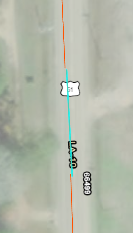

Hi all,
When editing a line feature in ArcPro the line moves over and doesn't stay in the same place as saved.
This applies to editing vertices, moving, and creating a new feature. However it only happens when I am snapping to the other line.
Before saving to new location
After saving to location
As you can see it's slightly moved over even though it snapped the first time
Any help would be greatly appreciated,
Thanks!

Scott_Harris
Hi Owen,
Are the two lines using the same coordinate system? What is the map's coordinate system? Does it match the lines? Are there any transformations being applied in the map?
Does the symbology of the line have an offset effect?
Thanks,
Scott
