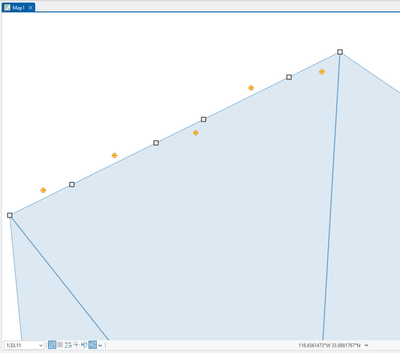

Just curious if there is a way to find and fix lines not snapped to points without having a Standard or Basic license?
TY
JenniferCadkin

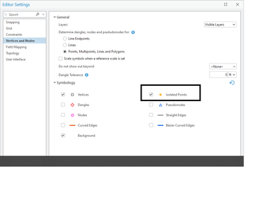

For visual inspection, you can try using Vertices and Nodes capability to see where unsnapped points are located- in Vertices and Nodes, they are called 'Isolated Points'.    Vertices and Nodes is available with ArcGIS Pro 3.5 and later.
https://pro.arcgis.com/en/pro-app/3.5/help/editing/symbolize-vertices-and-nodes.htm
https://pro.arcgis.com/en/pro-app/3.5/help/editing/change-vertices-and-nodes-settings.htm

Great! This is perfect. Thank you
