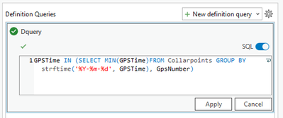

In any case, mobile geodatabases allow for complex SQL in definition queries, so I was able to copy query I used for the view into the Definition Query editor,  and get what I needed.
GPSTime
    IN(
    SELECT
        MIN(GPSTime)
    FROM
        Collarpoints
    GROUP BY
        strftime('%Y-%m-%d', GPSTime),
        GpsNumber
So, to make a long story short, my issue that spawned this post was not being able to figure out how to turn a datetime into a date. @RyanUthoff 's solution of just turning it into formatted text worked great and was exactly what I needed.

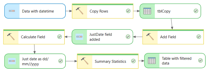

DuncanHornby
MVP Notable Contributor
You never specified the type of solution you wanted, Ryan gives you an SQL approach, below is a model builder approach using some earthquake data from living atlas.
An in-memory copy of the table is created to which I add a text field. I then extract out the date portion in the format of dd/mm/yyyy.
To extract just the date portion I use the calculate field script of:
justdate(!eventTime!)
from datetime import datetime
def justdate(dt):
    date_value = datetime.strptime(dt, "%Y-%m-%dT%H:%M:%S")
    x = date_value.strftime("%d/%m/%Y")
    return x

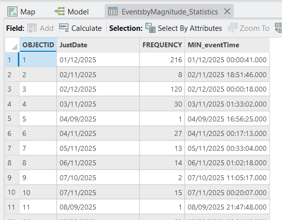

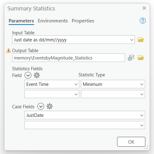

 I then run the summary Statistics tool as:
The result is a table filter down from 2000+ rows to 49 as shown below:
The frequency field gives you an indication of how many time stamps occurred on the day.
