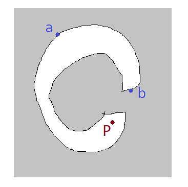

HI Gary
Do you need to measure distance 'as the crow flies' (the distance from P to 'a' in the figure below) or staying inside the polygon (the distance from P to 'b')?
In the former case, you can use a da cursor and the python geometry apis to find the farthest distance from your query point. In the second case you can use the Spatial Analyst DistanceAccumulation and Con tools.
Here are a few more details.
In the first case, you could get a quick approximate solution by densifying the input polygon boundary and then looping over all vertices in the polygon to find the farthest vertex from the query point.
In the second case you need to create a raster that represents the background portion of the polygon. For example, for the "C" shaped polygon above, the background raster would be these gray cells. After rasterizing the polygon, the IsNull and CON tools can be used together to create it.
You can then specify the gray raster as the 'barrier' parameter to DistanceAccumulation and the point P as the source parameter. Your output 'accumulation' raster will be the distance from each interior cell to P (travelling on the shortest path to P inside the polygon). You can then find the location(s) that have that maximum distance by using the CON tool, along with the 'max' value from the output accumulation raster's statistics.
