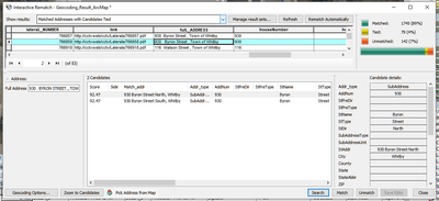

If I use ArcMap 10.4 to Geocode I do see the list of candidates shown:

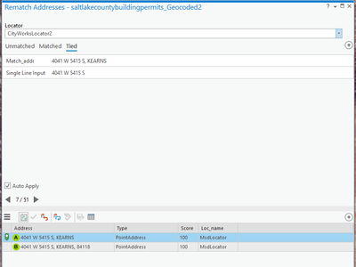

Interesting:  I'm getting something a bit different with my ties.  They show up matched to the same locator...
Seems like geocoding has become quite an adventure....
@ShanaBritt
edited moments later:  it it turns out that the 51 ties matching to the same locator is because there are duplicate address points with the same address.  I inherited this data, so it's time for me to clean it up.  But it still begs the question as to why I'm getting ties to show up and op is not...

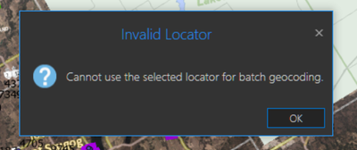

Whenever I try using the ArcGIS World Geocoding Service I get this error:
Is this the correct URL??

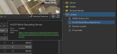

https://geocode.arcgis.com/arcgis/rest/services/World/GeocodeServer/ArcGIS%20World%20Geocoding%20Ser...
MichaelVolz
Esteemed Contributor
The portion up to GeocodeServer looks correct, but you cannot access the REST endpoint as it is disabled for viewing.

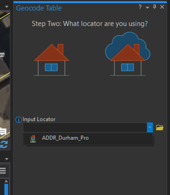

The World Geocode Service should be available by default in the dropdown list for address locators when geocoding a table of addresses.

The World Geocode does not even appear as an option, yet is in my projects Locators folder.

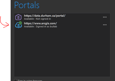

What is your active portal (AGOL or on-premise)?  Do you have the World Geocoding Service referenced in the active portal?
I had AGOL as the active portal and the World Geoding Service was registered there so it appears by default.  I switched the active portal to an on-premise portal and the World Geoding Service was no longer available by default.  This might explain your scenario.

My current portal for all of the above screenshots is:

3. I noticed that the candidates returned in ArcMap have an addr_type of Subaddress, but the input address is just <house number> + <street name> + <city>.  Are any candidates returned for '930 Byron Street, Town of Whitby' when enter in the Locate pane search box from your locator or the ArcGIS World Geocoding Service?
4. You would need to check that you have batch geocoding privileges in your organization to use ArcGIS World Geocoding Service, otherwise you would only be able to do geosearch or place finding (not batch). This would explain why you can see it and use it in the Locate pane, but not in any geocoding tools.

4.  I most likely do not have that privelege, so probably why it's not working.
