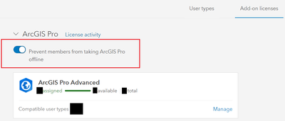

Organizations have the option to prevent members from taking ArcGIS Pro offline (In ArcGIS Online). By default, it's turned on.
The University Site license Administrator might be able to help you with this. They need to disable this option temporarily, during which you need to take the license offline. Once the task is completed, they should enable "Prevent members from taking ArcGIS Pro offline".
Only the authorized callers of your University will be able to create a support case from My Esri, if required.
