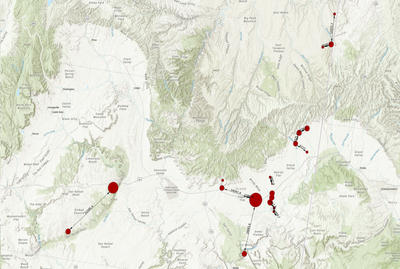

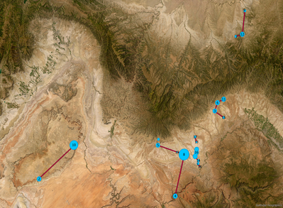

I'm trying to solve a distance problem where I need to get a set of distances between polygons and their next closest neighboring polygon. For example, for the blue polygons I need to know the distance between polygon #2 and #10, then #10 and #5 (a multipart polygon), then #5 to #19, #19 to #8, and so on.
Using Generate Near Table in ArcGIS, I can get the closest polygons to each other represented by the red lines, but there's gaps between clusters of polygons. Obviously, I create the whole set of pairwise distances between all the polygons, but then I'm stuck on how to subset that to the just the pairs needed to fill in the gaps (#10-5, #8-#16, #16-#13, #17-#3, and #11-#7.
Any ideas on how to solve this problem? I need to do this for a few thousand sets of polygons, so looking for an automated solution.

It's quite hard to follow your question, because your screenshot doesn't fit your text (polygons aren't labeled, colors are wrong)...
Are the blue lines what you want?

ChristopherTracey2
Whoops -- uploaded the wrong image. Yes, your interpretation is correct.  Correct image below:
DavidPike
MVP Notable Contributor
I don't understand what the #numbers are referring to in the image, where any blue polygons are in the image, or exactly what you need to achieve from your explanation so far.
ChristopherTracey2
Apologies - accidentally uploaded the wrong image. See the above reply.

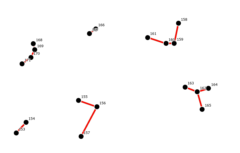

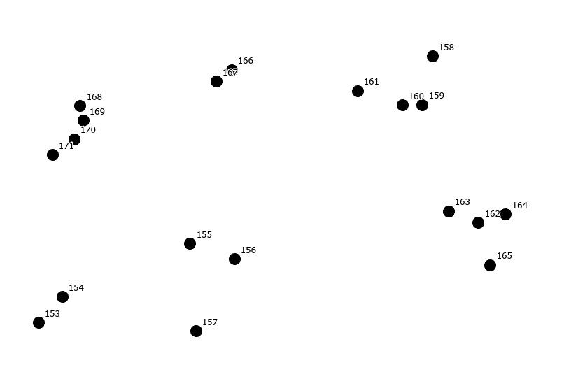

Input (points, but it should work with any geometry type):
Connections generated from a simple Generate Near Table:

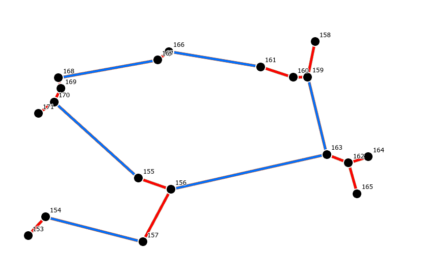

And the result of my script with connections between the clusters:
There are some cluster connections that aren't really necessary, for example between points 161/166, or 156/163.
Sadly, you can't just connect to the closest cluster, because then you could get "super clusters" of clusters that are each other's closest clusters, for example the two clusters in the lower left. That's why I look for the second closest cluster if I detect a cluster connection multiple times. The "correct" way would be to check if the cluster is connected to the greater network of clusters and if so skip the detection of a new cluster connection, but I'm too lazy to figure out a proper solution for that...
