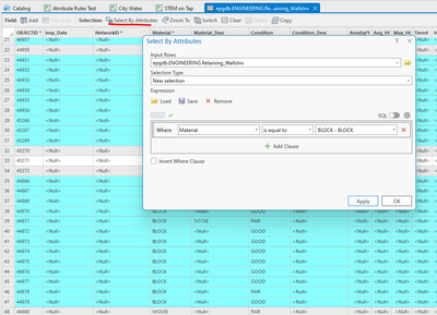

First, you will want to select by attribute. You can do this from the main ribbon at the top of ArcPro, or from the attribute table. Here's an example:

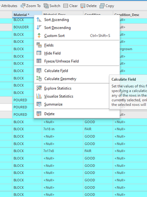

Then right click the column and select Field Calculator:
Then simply type 'Pasture' and all of only the selected records will change. Be aware though, this will change all of the Hammock into Pasture, even the ones that were Hammock before that previous change.
