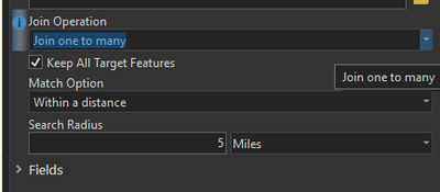

Spatial Join can match features based on "within a distance". That's where I would start.
