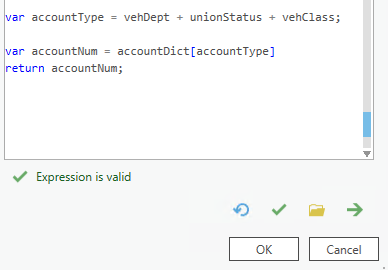

I'm trying to set up a calculation attribute rule to populate a general ledger account value based on the contents of some text fields, and I'm running into trouble with validating the rule. My Arcade script works when I run it as a field calculation, as a popup calculation, and even validates in the Expression Builder in the attribute rule setup. When I go to save the rule, I get an error of 002717: Invalid Arcade expression, Arcade error: String type expected, Script line 39 (that's line 18 in the code snippet below). Is this a bug, or is there something I'm doing wrong here? I'm using ArcGIS Pro version 2.8.3.

And proof that it's validating in the expression builder:
