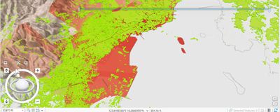

I am trying to display the 3d buildings in a city and I am using the Open street map 3D Buildings from ArcGIS Living Atlas. When I load it into my 3D layers, I see all the buildings outside my desired area.
I want to clip the buildings specific to the city but ArcgisPRO says003663: Scene service does not have extract capability.IrisYvetteCesista_0-1701954044281.jpeg

Have a look at this article for subsetting scene layers:
https://pro.arcgis.com/en/pro-app/latest/help/mapping/layer-properties/display-a-subset-of-features-...
Masking an area of interest from the OSM 3D buildings layer is the example they give, so it looks like you can get what you want by following their steps.
