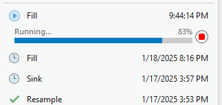

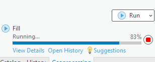

Hi, I was trying to run a fill tool to 10 m cell size DEM layer. While initially it runs fast then after a certain time it stuck in 83% processing time. It runs fast up to 83 % then totally stuck in 83%. I kept it running overnight but still it's showing 83% processed. What is the reason?. The DEM layer was previously 2.5 feet cell size which I resampled to 10m. Even in 2.5 feet it was completed within an hour but with 10m cell size it's taking that much time without any progress after 83%. I cancelled the tool, restarted the computer and again run the tool. But still, it is stuck at 83% processing.

Thank you for responding. I tried sink tool before running the Fill too. It also was taking forever to complete the sink tool. Then I had to cancel the sink tool (see history).
In the case of resampling, I used previously filled DEM which was 2.5 feet. Since I resample the DEM, I was thinking I have to fill the sinks. Is using already filled DEM creating this problem? I used nearest Neighbour technique for resampling. I checked the tool now, it's still stuck in 83%.
