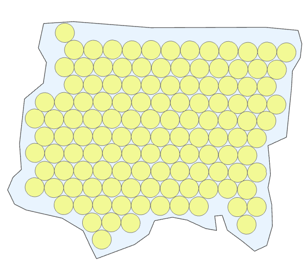

I want to find how many of Polygon B can fit into Polygon A. I have a database of water bodies in the US as polygons of various unique shapes, 'Polygon A'. I have another layer with 'Polygon B'. Does ArcGIS have a tool to calculate how many times I could fill Polygon B into each waterbody polygon without Polygon B overlapping with itself?
Right now, I have a process that utilizes the Intersect Analysis tool however, I am hoping there is a tool that would Fill all water body polygons with the maximum number of Polygon B. Polygon B is a simple circle and can be converted into a different layer type (polyline etc) if needed.
4 Replies
Alvarado10
Above is a photo with the desired outcome from the analysis

You are looking for "circle packing"
python - Covering irregular region with circles - Stack Overflow
and there are no builtin tools.
Your best approximation would be to
  • generate a hexagonal grid in your polygon extents
  • take the centroid of each centroid
  • buffer the centroid
  • keep the circles (aka, buffers) that are completely within the polygon bounds
It won't be exact since you might have to algorithmically jiggle the start coordinates of the hexagon-ization to fit in a few more.
Not an easy task... but can be "close enough" for many purposes

What tool would you recommend to keep the circles? There's a few options that work but with the large amount of data, processing time is quite slow. I would like to have a table generated that shows the original data from the water body layer with a new column showing how many circles are contained within each waterbody feature.
DanPatterson
MVP Esteemed Contributor
The process I described is meant to do one water body at a time.  "circle packing" is complex
A close approximation would be to use hexagonal tiling of the whole area, then intersect or spatial join these to the water body layer
