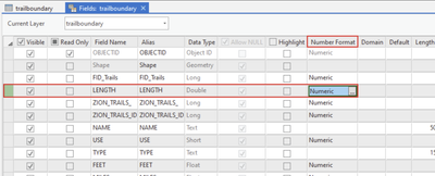

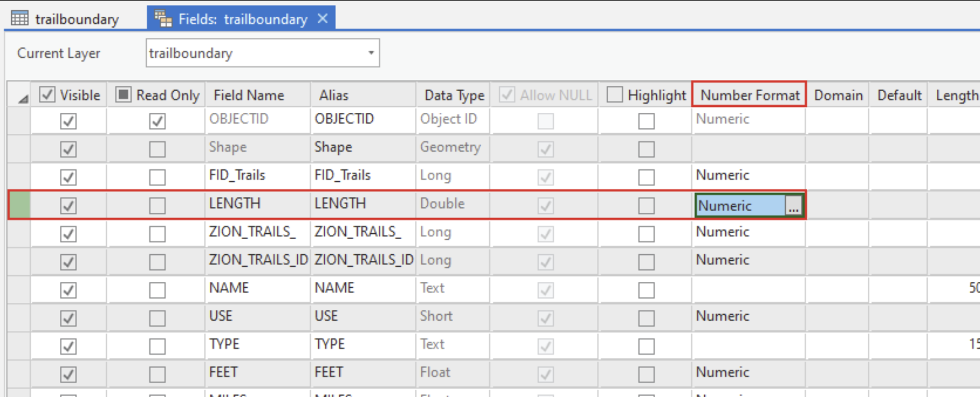

I only found this on the topic: How To: Customize Numeric Data Precision and Scale in ArcGIS Pro (esri.com)
But if we look at the screenshot here How To: Round off Numbers to a given Number of Decimal Places in an Attribute Table and La (esri.com... precision and scale are not listed:

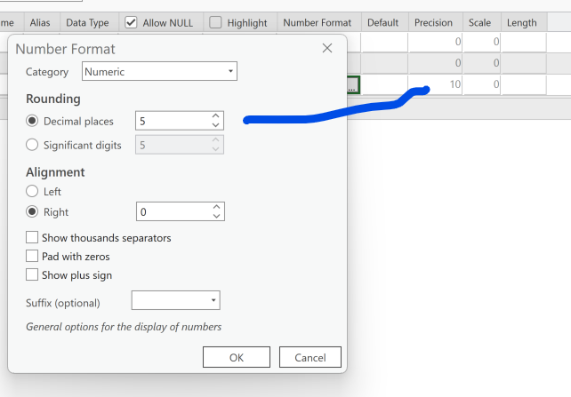

When I set the Decimal places in Number format to 5 and export the Feature Class to Shape, this is the result:
It would be great if someone could explain this behaviour 🙂
DanPatterson
MVP Esteemed Contributor
from
Add Field (Data Management)—ArcGIS Pro | Documentation
Note:
Field precision and scale are not supported in a file geodatabase feature class or table. If you enter a value for precision or scale, it will be ignored.
subsequent to the Note is more description as to what happens and what field types are specified for data types
