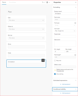

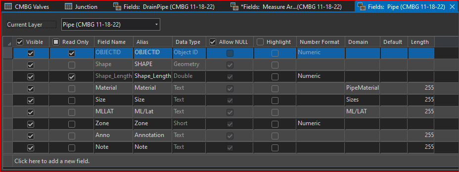

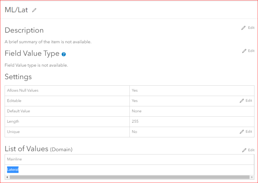

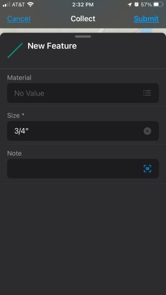

I'm having an issue where fields are editable in Pro and Online, but not Field Maps. There are no contingent values applied to fields for this feature or other effected features. See pictures and captions below.
Summited to pro as this is where I started this feature's life and therefore is the first place I could make a mistake upstream.

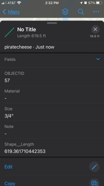

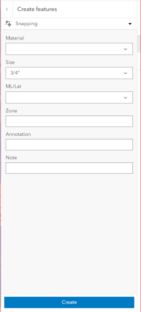

Set up the field in Pro. All visible, none read only.Set up the field in Pro. All visible, none read only.Uploaded to Online. I can edit and submit with all fieldsUploaded to Online. I can edit and submit with all fieldsBut when I collect in field maps, the field isn't available.But when I collect in field maps, the field isn't available.After submitting, the fields I couldn't edit are not visible.After submitting, the fields I couldn't edit are not visible.No red flags on the feature settings in OnlineNo red flags on the feature settings in Online

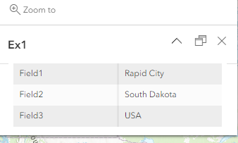

  3. My current pop-up looks like this:
  4. Go to Fields List
  5. I don't want to see the State (Field2) in my popup, so I'm going to remove it from the listAlfredBaldenweck_4-1670525986397.pngAlfredBaldenweck_4-1670525986397.png

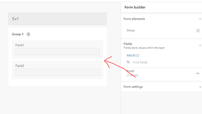

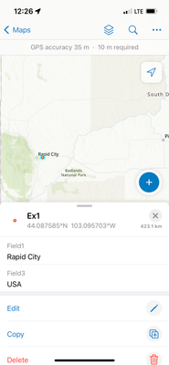

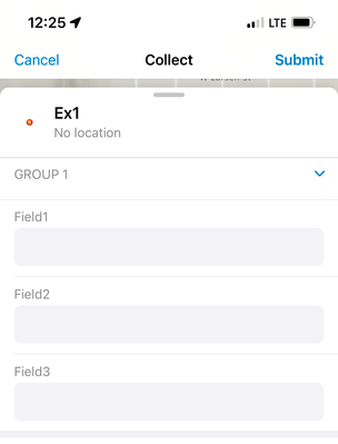

In this case, I want users to edit the State, but I don't want to see it after the fact. So I'm going to drag the field into the form, so it'll show up during collection, but not in the pop-up after collection. (You can of course make it so you can see things in the pop-u that aren't available during collection).
Final result:
Hope this helps!

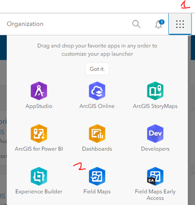

Either in the FieldMaps Site or from New Map Viewer , go to the form for the feature class.
FieldMaps web app
MapViewer
From there, you can add the fields to the form that you want

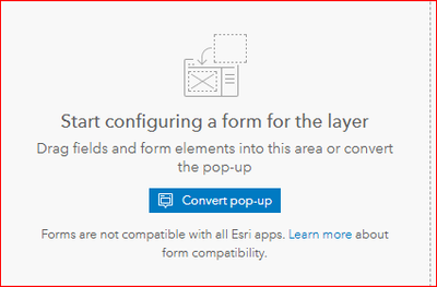

I don't know if it's correct that when I first entered the field map I was shown the message below. This tells me that despite seeing a form before setting this up, I have no forms. Is this normal or does it suggest I made an error in Pro?

My apologies, I wrote that original reply in a hurry, so I wasn't as thorough as I could have been.
Regarding the first question, I think it's possible that you didn't save the WebMap when you made the form, so it wasn't there when you revisited it. Otherwise, yeah, there's not a default form.
