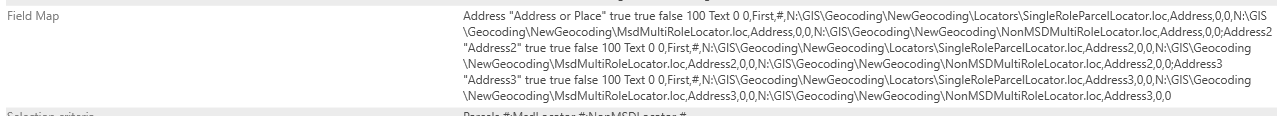

It's easy to split the parameters at the semicolon, and makes it much easier to read in the python script itself.  However, when it comes to splitting out the parameters of a composite address locator, it's not as straight forward.  Here is the output from the tool:
That's one long line.  I can copy that single line into my python script but I can't read it since it goes on for about a mile:
fieldMap = r'Address "Address or Place" true true false 100 Text 0 0,First,#,N:\GIS\Geocoding\NewGeocoding\MsdMultiRoleLocator.loc,Address,0,0,N:\GIS\Geocoding\NewGeocoding\NonMSDMultiRoleLocator.loc,Address,0,0'
Does anyone know where to put the line breaks in as shown in the first python window?
