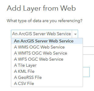

In order to feed the data into a web-accessible format, the database needs to at least be registered with an ArcGIS Server, otherwise the layer will only be accessible in-network. That said, if you do publish it to a standalone server, you can bring that layer anywhere, so long as the service is public.

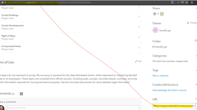

For example, we have an Enterprise instance with a great many layers. We do use AGOL as well, but for a subset of those layers. We can add them as AGOL content items via their service URL, and this does not use any credits.
You can think of it like adding a program shortcut to another folder. It's not "there", there's just another point of accessing it.
If the data is not registered with an ArcGIS Server instance, the only way to get it on the web is to copy the data into a hosted feature layer of some kind, which will use credits. Additionally, the published layer will only be a snapshot of the data at the time of publishing, and you'll need an additional process in place if the data is to be refreshed.
