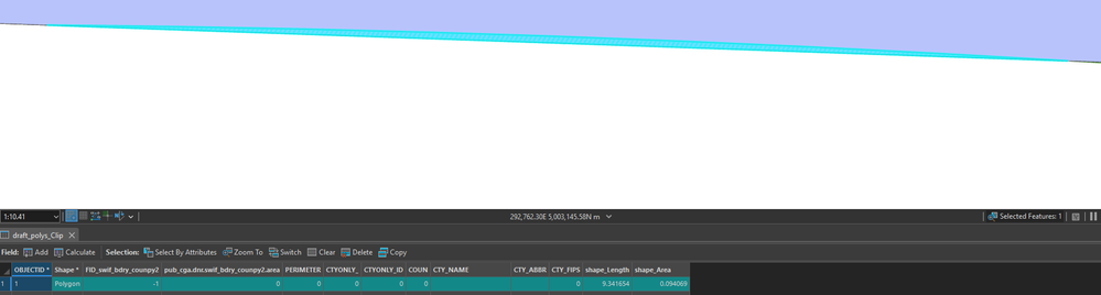

I'm running the Feature to Point tool in ArcGIS Pro 3.4.2 on a set of polygons in order to create centroid points within those polygons. The tool keeps throwing an error when it gets to a very, very small polygon in my feature class (see screenshot below for visual and note the length and area fields, UTM coordinates).
The error thrown suggests there could be something wrong with the geometry and that I should run the Repair Geometry tool. I have done so, but there's no indication of any geometry errors and the Feature to Point tool still throws the same error afterwards.

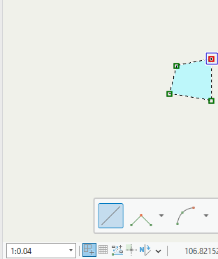

I don't think it's documented, but there does seem to be a minimum feature size; I'm zoomed in at 1:0.04 here and it won't let me finish this polygon
I think the minimum may be like 1cm in any direction.

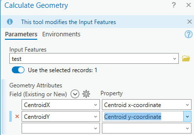

Thank you for the suggestion. I was able to manually calculate the XY centroid for this polygon in particular---both using the Python script you provided and the Calculate Geometry tool. The resulting XY point appears to be correct (see below).
I've been using the Feature to Point tool in a custom script to convert mapped topography contours into polygons and then automatically labelling the elevation range of each polygon based on their bounding contour value.
For now, I'll revise the script to calculate and generate the centroid points using your suggested method. I think this is something worthy of investigating further at Esri though. It seems a bit silly that I can produce an inside centroid point through this method yet the Feature to Point tool fails to do so.
