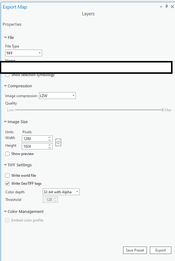

  2. An r,g,b raster is created by Share -> Export Map -> Geotiff Map, using the settings in the below image.
