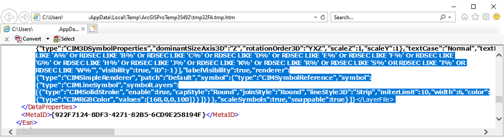

For our notes, Save As —> Save as XML —> All Content is greyed out.
This item has authored FGDC metadata that must be upgraded to ArcGIS metadata format before it can be used in ArcGIS Pro.
View Content
But I can I can click View Content which opens an XML file in Internet Explorer.
Like you mentioned, I can see the labelling and symbology properties in the <LayerFile> tag:
..."whereClause":"RDSEC LIKE 'A%' Or RDSEC LIKE 'B%' Or RDSEC LIKE 'C%' Or RDSEC LIKE 'D%'
Or RDSEC LIKE 'E%' Or RDSEC LIKE 'F%' Or RDSEC LIKE 'G%' Or RDSEC LIKE 'H%' Or RDSEC LIKE
'J%' Or RDSEC LIKE 'K%' Or RDSEC LIKE 'R%' Or RDSEC LIKE 'S%' OR RDSEC LIKE 'T%' OR RDSEC
LIKE 'W%'","visibility":true,"iD":-1}],"labelVisibility":true,"renderer":
{"type":"CIMSimpleRenderer","patch":"Default","symbol":{"type":"CIMSymbolReference","symbol":
{"type":"CIMLineSymbol","symbolLayers":[{"type":"CIMSolidStroke","enable":true,"capStyle":
"Round","joinStyle":"Round","lineStyle3D":"Strip","miterLimit":10,"width":6,"color":
{"type":"CIMRGBColor","values":[168,0,0,100]}}]}}},"scaleSymbols":true,"snappable":true}]}
</LayerFile>
The full XML file seems to have some somewhat sensitive connection information in it. So I won't post it publically. But I can send it to you in a private message. Maybe between the two of us we can figure out what GP tool, model, or script inserted the layer file into the metadata.
I've also asked my colleague if a GP tool, model, or script was used on the FC. Waiting to hear back.

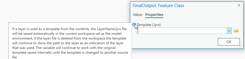

I stumbled across the layer file embedded in metadata scenario while working in ModelBuilder in AGP 3.2.2. For test purposes, I ran 3 GP tools as single processes in ModelBuilder: Buffer, Export Features and XY Table To Point with Single Symbol and Unique Values symbology and got consistent embedded layer files in the output's metadata when using this workflow:
  • Add the target feature class (stored in the Project's Home fGDB) to a Map --> symbolize.
  • Start a Model
    • The Model's current and scratch workspace environments are the Project's Home fGDB.
    • On the Model canvas --> insert the GP tool such as Buffer.
    • Set the tool input to the layer in the Contents pane and other necessary parameters.
    • Double click on the output element --> click on Properties. The Template (.lyrx) should be blank.
    • Use the pulldown and set the Template to the symbolized input layer in the Contents pane --> OK.
    • Validate and Save the model.
    • Run the Model
Before you do anything else, locate the newly created layer file in the Project's Home folder and delete it.
Check the results as follows:
  • Add the new output feature class to the current Map or any Map in the Project to see if the symbology came across.
  • Copy the feature class to another location and add the copy to a Map in this or another Project to confirm that the Symbology is coming with it.
  • From a Catalog View, save the new feature classes metadata to an XML file.
    • Open the XML file and search for (tag) layerfile to see the embedded info in the metadata.
Might have something to do with this:
Other workflows and data types might or might not work.

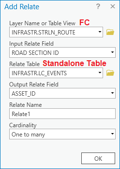

ArcGIS Pro 2.6.8; Oracle 18c 10.7.1 EGDB:
It looks like the Add Relate tool is the culprit (I didn't test Calculate Field). I'll send you a video in a private message.
Steps:
I'm working in a different environment --  a dev environment.
  1. Create a new ArcGIS Pro session/project.
  2. Add FC to map.
  3. Apply symbology using a default symbol from the gallery.
  4. Apply the SQL expression from the XML file (from the prod FC).
    RDSEC LIKE 'A%' Or RDSEC LIKE 'B%' Or RDSEC LIKE 'C%' Or RDSEC LIKE 'D%' Or RDSEC LIKE 'E%' Or RDSEC LIKE 'F%' Or RDSEC LIKE 'G%' Or RDSEC LIKE 'H%' Or RDSEC LIKE 'J%' Or RDSEC LIKE 'K%' Or RDSEC LIKE 'R%' Or RDSEC LIKE 'S%' OR RDSEC LIKE 'T%' OR RDSEC LIKE 'W%'
  5. Enable labelling via right-clicking the layer in Contents.
  6. Rotate the map to -19 degrees.
  7. Add a standalone table to the map that will be related to the FC.
  8. Use the Add Relate tool to relate the FC to the standalone table.
  9. Point to related records: FC —> standalone table.
  10. Add FC to the map (again).
  11. The symbology and labelling persist in the new feature layer.
  12. Close ArcGIS Pro and re-open; create a new project.
  13. Add FC.
  14. The symbology and labelling still persist in a new project/session.
The steps only seem to "work" (permanently apply symbology and labelling) about one in every three times. I’m not sure why it only works sometimes.
I’m not sure if all of those steps are necessary. Likely not. It was kind of fiddly to test, so I ended up just finding a set of steps that worked and sticking with them.
The steps can also be used to remove the permanent symbology and labelling if it already exists.
It’s pretty strange behavior. But if I'm understanding your comments above correctly, it sounds like it’s been removed in newer versions of Pro.
