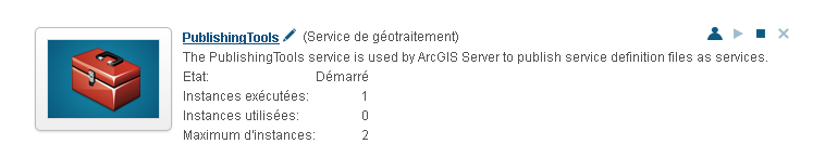

I have the error below :  the PubishingTools service could not initialize,  in ArcGIS Server:
"com.esri.arcgis.discovery.ejb.ArcGISServerEJBException: Could not initialize service 'System / PublishingToolsEx.GPServer'."
By checking this information in ArcGIS server, I see that the service has started successfully.
Please, anyone knows how to avert this error ?
