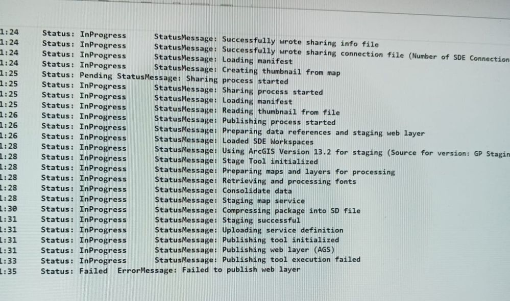

Failed to publish web layer

Hard to say, check the uploaded definition what happen if you Publish it manually - I guess it will give an error but you can try.
Fix geometries? Field names?

are you trying to publish a MapService from SDE data to local ArcGIS Server?  If so, I have seen this error when I had to register the database with the server.  Even though the data IS already registered, and Server Manager validates it, re-register with different name often makes it work.
If not, not out much testing....

Have you tried publishing other data from the same database?
