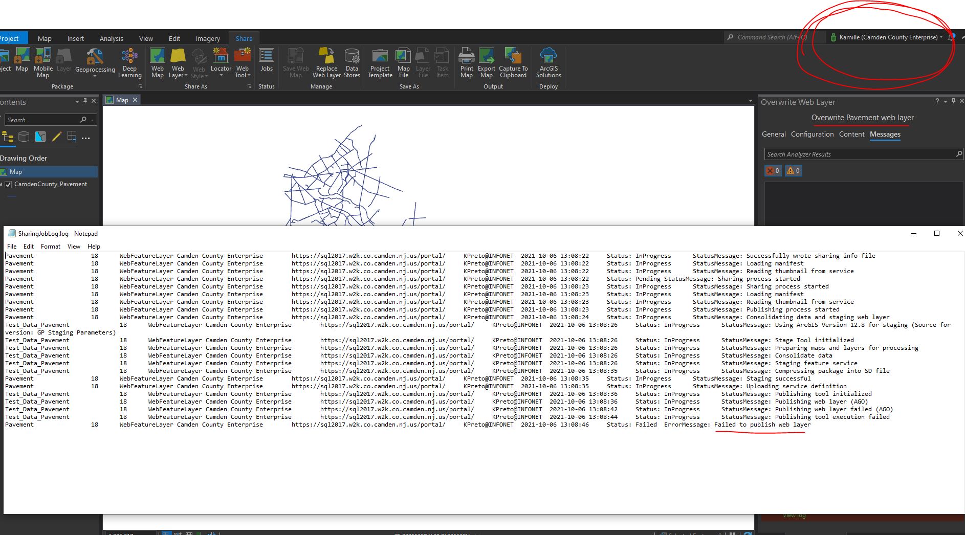

This is the first time that this error is happening. I am trying to overwrite an existing web layer in Enterprise (which I've done many times before). I am receiving a failed error, and I have no idea why. The log is pretty basic and doesn't really give me an idea of what's wrong, except that the publishing tool execution failed.
Does anyone have any ideas?
I just tested out re-publishing it, instead of overwriting, and it does the same thing.

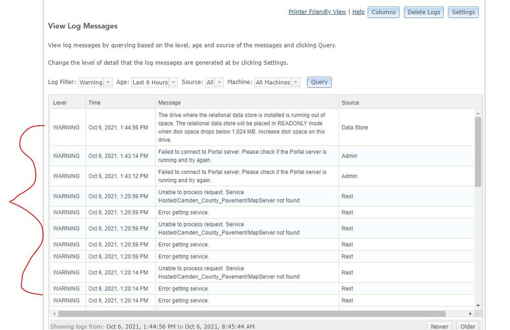

I also just had our IT Dept restart our GIS Servers. It's back up now, so I tried again and it is still not working. I opened up the Server Manager logs and this is what is showing.
