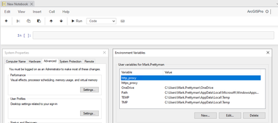

Hi @TylerT !  In my case, I had the http_proxy and https_proxy variables set in my "User variables" within the "Environmental Variables."  Here is a screenshot from one of my trials...but after I deleted the ACTUAL proxy value and just set it to a single space.
Previously, the proxy variables were set to:  http://first%2Elast:password@wwwcompanyproxyURL:port
IF your company is using a proxy, your proxy URL would be different, but the variable might be set up similarly.  I'd definitely check with your IT to determine how your computer is configured and may be using a proxy.
