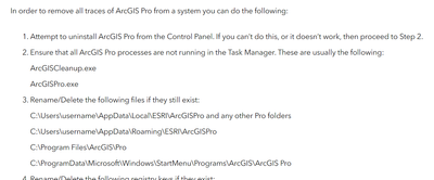

If Shaun's suggestion to create a custom environment from scratch works, then you may want to try Clean uninstall of ArcGIS Pro - Esri BeLux to fix the corrupted installation.

2. If notebooks work in Pro with that clone active, you can either continue working with it from now on or (recommended) try Clean uninstall of ArcGIS Pro - Esri BeLux to fix the default. NOTE: Never install any packages directly into the default environment arcgispro-py3. Always clone first, then install your packages. That way, if the environment becomes corrupted, you'll always have a fallback in the default.

Prior to the 3.1.0 update we did perform a re-install.  It wasn't clear to me that the python packages were un-installed / re-installed.  Are python packages and default environment re-built with a clean install?
The Clean uninstall of ArcGIS Pro - Esri BeLux article is for non-fully uninstalled software.  Is this applicable, or can we just un-install re-install?

Yea, the package set in the default environment changes with each release. Normally the Python packages will uninstall and reinstall and you'll have no problems. But under some circumstances (like when packages are installed directly into arcgispro-py3) there will be files left behind. This may cause issues with the next version of Pro installed as well. That's why I was stressing in my previous reply to never install any packages directly into arcgispro-py3, it can cause you trouble. Always clone if you want to install packages.
In your case running through the steps in Clean uninstall of ArcGIS Pro - Esri BeLux would help rule out corruption of the arcgispro-py3 environment that may be persisting through your Pro installations.

1) I guess I'm failing to see how a Clean uninstall of ArcGIS Pro - Esri BeLux  is applicable.  I don't get past step one since uninstalling is not my issue.  The software uninstalls just fine.
