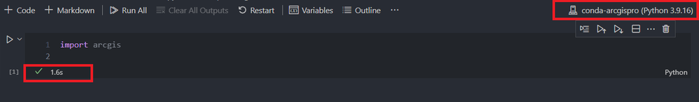

by Anonymous User
Not applicable
Yes, it works out of ArcGIS Pro when I open the notebook with VS Code and set Python interpreter path below.
C:\Users\user_id\Anaconda3\envs\conda-arcgispro\python.exe
But it doesn't work with the shortcuts on start menu. Shortcut paths need to be updated.
