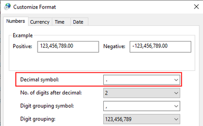

The source of the problem is that the Export Training Data For Deep Learning tool is using your Windows regional settings when exporting the training data. If you have decimal points set as commas then the numbers will be exported as shown: 321,12.
Unfortunately the prepare_data python script is expecting decimal points as points: 321.12. Until ESRI fixes the problem you may have to change your language or decimal point setting in Windows and export the training data again.

Changing the language may not be enough - somewhere in your Windows regional settings there should be a setting for the decimal symbol - make sure it is set to the point and not the comma. You will have to export your training data again.
I would suggest a reboot after doing this, and maybe starting a new project in Pro as well.

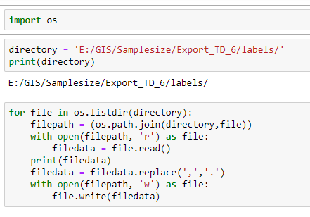

Tried these steps but where not enough. Chould neither change settings in ArcGIS Pro, (dont know if it's region locked due to school license?) But ended up with script that solved the issiue:
Nevertheless thank you for trying to help and answering!
