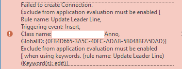

I have a junction feature class A, a feature-linked annotation B and a leader line feature class C. Now, I have implemented a attribute rule on B to auto-create leader line on C but failed. "Failed to create Connection......" is prompted after creating new point.
