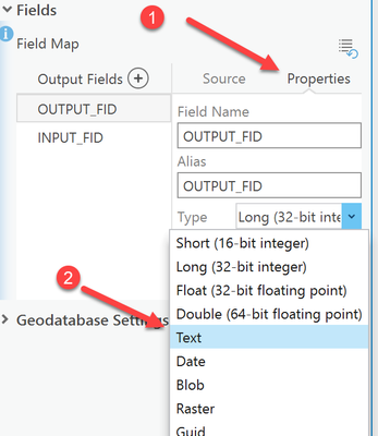

With TableToTable, you don't have to let the software do its best guess, you can control the output type, order etc under fields and properties

If I change the field type to Text, it still converts the time to a date, and then places it into the Text field.
(Also I then end up with only 4 of my 20+ fields? i.e. it only lists a few of the fields in that Field Map section?)
