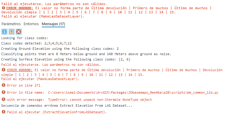

Hello, I'm following the lesson Extract Roof Forms For Municipal Development and I'm having a problem in Extracting Elevation Surfaces from LAS datasets step. I can't create the three elevation layers and getting the following error:
The error says that the parameters are not valid and shows that there is an error with the bm_common_lib.py script. I do not understand the error very well, I am following all the steps and I have repeated it several times.
Any suggestions would be greatly appreciated.
Thank you so much.

Thanks for the reply!! That is the link I am following but I have a problem in step 9 of Extract elevation surfaces from LAS datasets. In that step, three rasters should be created and it gives me that error.
Sorry for not explaining the problem well

Sounds like a data error, or it can't find something. Are you using the sample Portland data that comes with the guide or your own data?
IsmaelLamas
First I tried it with the data from the Portland example and when I did not get it I tried it with other LiDAR data and in both cases I got the same error. I don't really understand why

Hi Ismael, I forwarded your message to the Learn ArcGIS team. They reproduced the error and have prioritized the lesson for an update. Unfortunately, I don't know exactly when that will happen.
