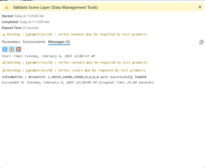

sevinc4maps
I get this type error.
Andrew--Johnson
Ok looks like just a warning so that should not impact the output of the tool. You could try sketching one polygon footprint on the mesh and running the tool to see if it's an issue with the footprint polygon. Otherwise if you want to share the slpk I can take a look too.
