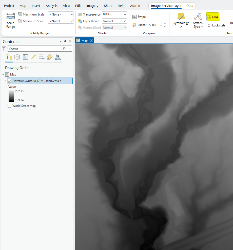

I can open the .LYR file in ArcGIS Pro. The default symbology is "Stretch".

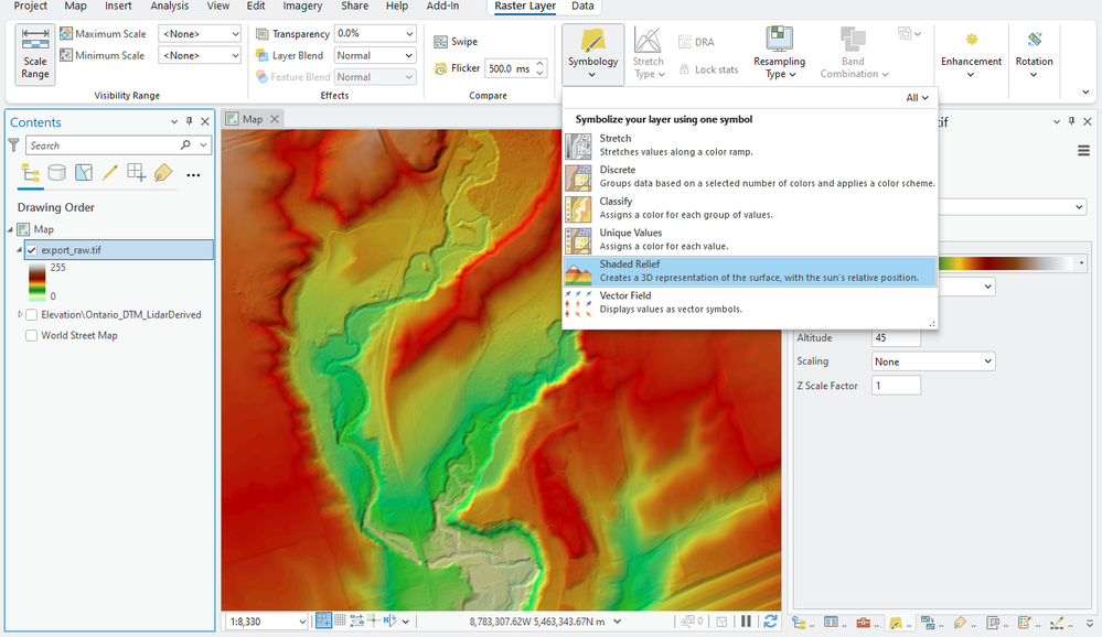

  1. Right-click the layer in the Contents pane > Data > Export raster. Export as a TIFF.
  2. Using the resulting file:
    Now that we're dealing with a smaller subject area, change the symbology to Shaded Relief. The raster symbology shows up better with a smaller subject area because the gradient has a smaller range of pixels, so there's more contrast.
  3. Export the raster to a TIFF again, but this time enable "Use Renderer" and "Force RGB". (We can't export as a JPEG because we'll get an error.)
