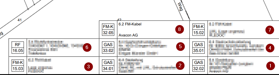

Dear Community,
I am currently struggling the following topic:
All I need are dynamic boxes that are displayed depending on the current number of features in the map section (Layout). The aim is to print a series of maps.
Desired result:
2025-02-07 14_09_57-LH-09-1234_LAGEPLAN_022_025.pdf - Geschäftlich – Microsoft​ Edge.png
Current state:
Can anyone advise on this or is there already something on the forum?
Thanks and best regards,
Christopher
RichardHowe
I would suggest perhaps that you might be able to use dynamic table frames to achieve something akin to what you are looking for. You can make records map series dependent. I don't think it would work exactly as per your example screenshot, but something to look into

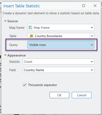

AubriOtis
You can possibly use dynamic text statistics. There is an option to only calculate the statistics on the visible features. Learn more in the Add and modify dynamic text help topic.
Cheers,
Aubri
