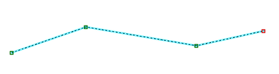

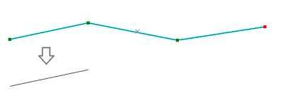

JohannesLindner
MVP Alum
  • copy your feature class
  • run the script below (change path to the copy)
with arcpy.da.UpdateCursor("fc_path_or_layer_name", ["SHAPE@"]) as cursor:
    for shp, in cursor:
        new_path = shp[0][:2]  # first part, first and second vertex
        new_shp = arcpy.Polyline(new_path, spatial_reference=shp.spatialReference)
        cursor.updateRow([new_shp])
JohannesLindner_0-1655282142907.pngJohannesLindner_0-1655282142907.pngJohannesLindner_1-1655282315693.pngJohannesLindner_1-1655282315693.png
Have a great day!
