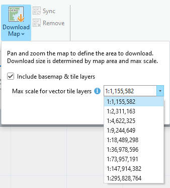

Does anyone know how to specify an extent, rather than just using the current map extent? My map is really huge and I'm drawing it at 1:480,000. The drop-down for the scale has 1.1M as the most zoomed-in extent.
My guess is that my map is just so big that it doesn't want to let me download that many features/tiles. It feels like I need to export this in tiles, and using screen extent feels rather imprecise. I can't find a GeoProcessing tool to do this, but maybe I'm missing something. Any other ideas?
Or, if I download slightly overlapping areas, can I clip them to create meta-tiles (of tiled layers)?
BrettLessner_Nsight
@davedoesgis,
Not that I've seen. The tool says "Pan and zoom the map to determine the area to download." In my experience, that was the only way to change extent of the export. If you play around with your current map extent you'll see that the larger scales become available in the Max scale dropdown as you zoom in.
Overall, there just isn't a place to set parameters like one can in the Export Tile Cache and Manage Tile Cache tools.
-Brett
davedoesgis
@BrettLessner_Nsight- Agreed. If there's a GP tool or some API, I'm not aware of it, so it looks like the current map extent is the only way to set the extent.
If you have to download it in multiple extents to get the scale you want, you want tiles that are non-overlapping. Many of the polygonal features, like parks, use partial transparency to display a hillshade behind it. Any overlap will really stand out. I found some Python code to map the extent of a map and it ran, but did nothing. Not sure if I was doing it wrong, but I couldn't get it to work. Very similar code applied to a layout worked. If you activate the layout, the download map function is enabled. Here, I have downloaded the map for the current map extent and pan the map to the right/east by exactly the width of current extent to get non-overlapping extents.
