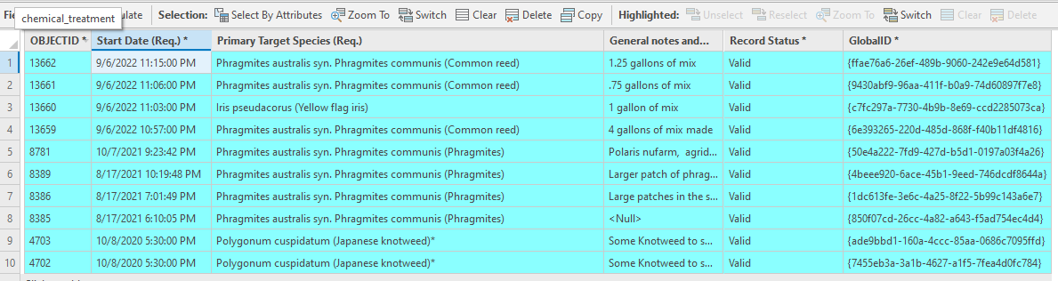

I have a Rubbish_Bins feature class in my SDE, this has GlobalID (type is Global ID) column as per below screenshot:
You can see all the global ID's are populated.

I have this problem when using Export function from within attribute table in ArcGIS Pro 2.9.5.  Global ID field is definitely set in the table, but the exported *.csv file has null data.

My work-around that I have used a few times is I create a new field GlobalID_copy. Calculate the field to = the GlobalID field. Then when you export to xls/csv they do not get deleted and you can copy and paste them back into the GlobalID column.
Excessive but it does get the job done.

Thanks Jessica.  I tried a different workaround: I exported the table as a dbf instead of csv and then just changed the dbf extension to csv.   For some reason, the Global ID is correctly exported in that case.
