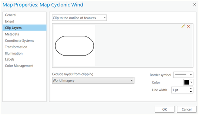

I have a similar issue working with ArcGIS Pro 2.7.1. I have a layout with a Map Frame that uses "Clip Layers" functionality. The map frame uses Robinson projection and I'd like to have a border clipped to the Robinson projection extent. The "Clip Layers" function works as expected and I've set up a border symbol:

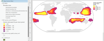

and my layout looks good:

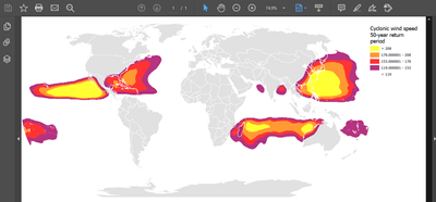

However, when I export the layout (to PDF, JPEG, PNG) the border is not there:
Is this related to the same bug? Any suggestions would be appreciated.

It is not the same bug. I suspect that you may be running into an issue where the export is not recognizing the border "feature" in the map view for some reason. My guess is that the export code sees this border as being outside the bounds of the map extent/projection and doesn't draw it. It could be related to the layer that you are using to clip the map frame as well.
Since this is probably a bug can you contact Esri Support? They are better equipped to handle troubleshooting steps and gather bug data. They can be contacted at https://support.esri.com/en/contact-tech-support.
As to a work-around - I haven't run across this so I don't have any good suggestions other than to increase the width of the border or to use the clip features themselves as the border by excluding the clip layer from being clipped.  You may have to play around with this, but it may work.
Thanks,
Tom
PS: I can confirm that the clip border does get dropped from the export no matter how thick the line is.  This is a bug.  The workaround with using the clip feature as a border does work. You just need to include it as an excluded layer (from the clip) in order for the line width to be consistent.
