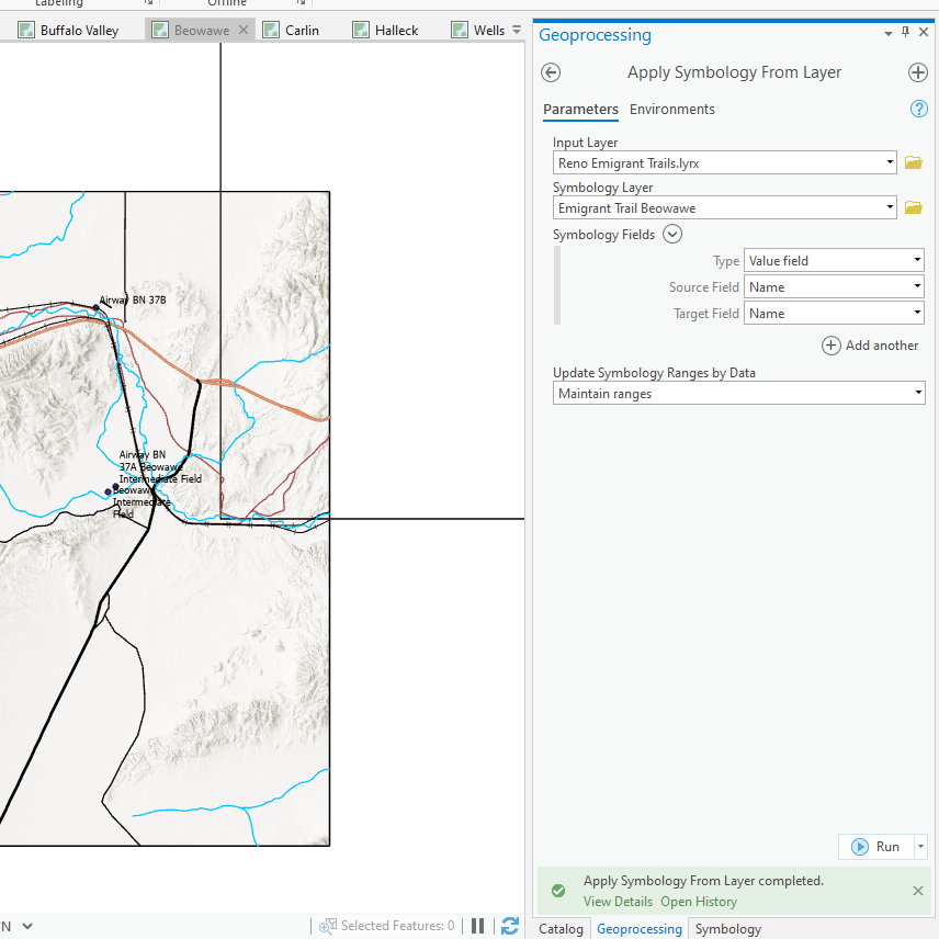

Hi Linda;  The issue remains a puzzle. I redid everything including the export of the source layer. The attached screen capture shows the setup of the Import Symbology menu. On the left hand side in the contents pane, nothing changes. I am trying to get the target layer on one map take on the same linetype and size settings as the source layer from another map in the same project. And the symbology just doesn't changeCapture_Symbology_Import.PNG to that of the source.    ??????       Dave

Hello Community;   After a month of tinkering on and off with this issue, I still haven't found a solution. Import symbology is supposed to work, but just doesn't and others have said it appears I have done everything right and that my example is not all too complicated.  Any further thoughts on this vexing issue?    Thanks;   Dave
VikasBaranwal
Hi DavidGray1, Could you make it work out? I just tried and it worked perfectly fine.  You have to choose defined symbology one as symbology layer and your layer and input which you want to define new symbology in Apply symbology from layer. If name of field which you want to symbolise are different in these two layers then you have to give them same names. Good luck
