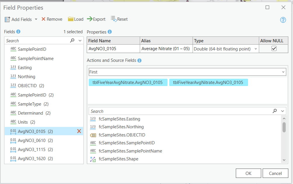

In Pro 3.2 -- When running the Export Features tool on a feature layer with a table join (validated 1-1) the field map is stating that the fields from the join table have two source fields and it looks like the source field is being duplicated in the dialog. Anyone else seeing this? Export works as expected (action is set to First) I just think it's a little odd.
In Pro 3.1 I just get one source field which is what I'm expecting.

I raised the duplicate field map inputs from the original topic with ESRI and was told the behaviour was expected, I did not pursue it any further.
