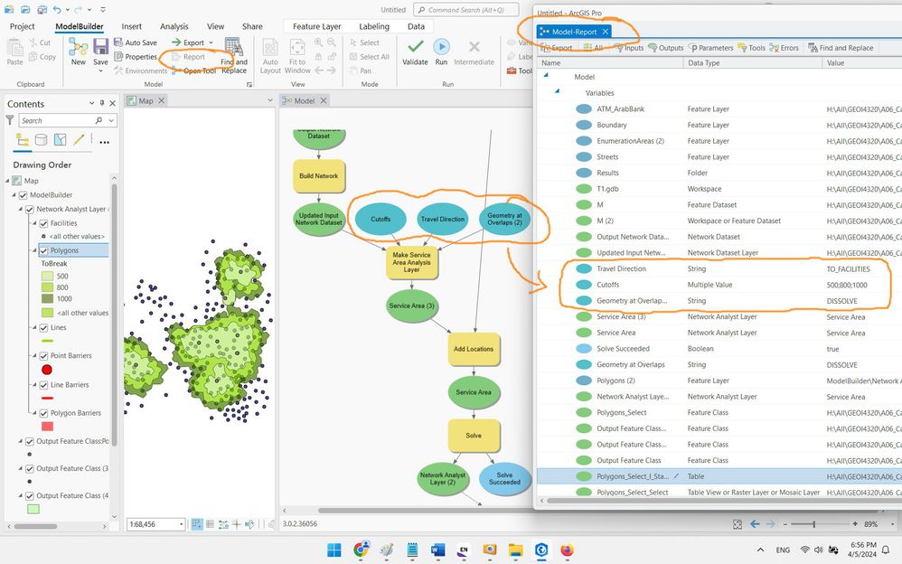

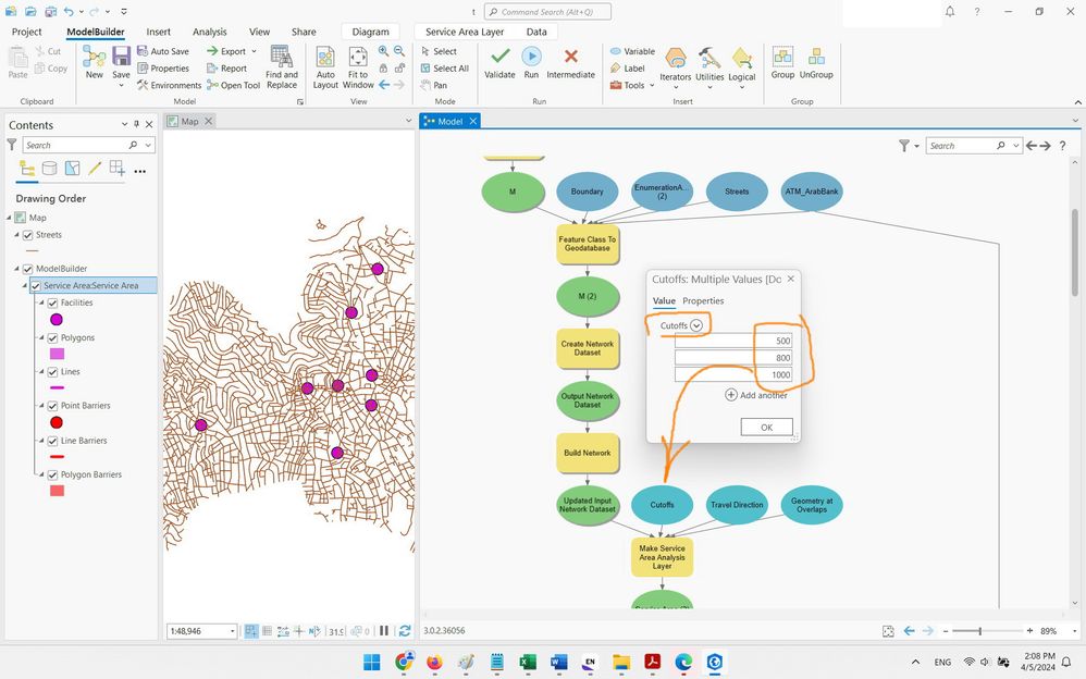

For example, in the screenshot below, the “Make Service Area Analysis Layer” tool has a "cutoffs" parameter. This parameter has thClip_1007.jpge values of 500, 800, and 1200. How can these values be displayed on the model?

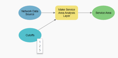

So the values can not be displayed dynamically on the map, unless you create a label and manually fill in the label with the values, for example:
The label will follow the parameter if you move the parameter, which is nice.

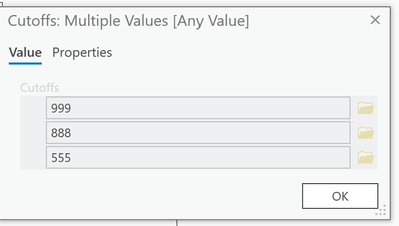

You can also hover over the parameter and the values will be dynamically displayed:
You can also create a report via the ModelBuilder tab | Model group and it will display the values for the parameter as well as other model information.
I hope this helps!

The report does provide the values for the parameters used in the model. However, it appears that there is no option to print it as a PDF file.

Ah.... no report as a PDF, just as an XML file 🙁
Perhaps you can add that functionality as an "Idea"?
@Dale_Honeycutt suggestion may be a way forward also for you?

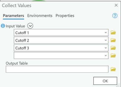

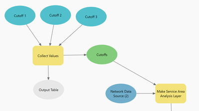

Perhaps this is what you're looking for.  I created 3 new variables of type Double (Cutoff 1, 2, and 3) and then used the Collect Values tool (found in the Utilities menu in ModelBuilder) to collect these into a multivalue of doubles.  The output of Collect Values can then be connected to the Cutoffs parameter of make service area layer.
(Just to be clear, I renamed the output of Collect Values from the default to 'Cutoffs'

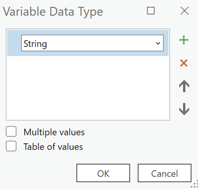

To create those 3 double variables, right-click on blank space in your model and chose 'Variable' (Ctrl+E).  You'll get this dialog:
There are a LOT of different variable types you can create -- it's kinda interesting to scroll thru.  But I digress -- press the 'd' key a bunch of times and eventually 'Double' will show up.
