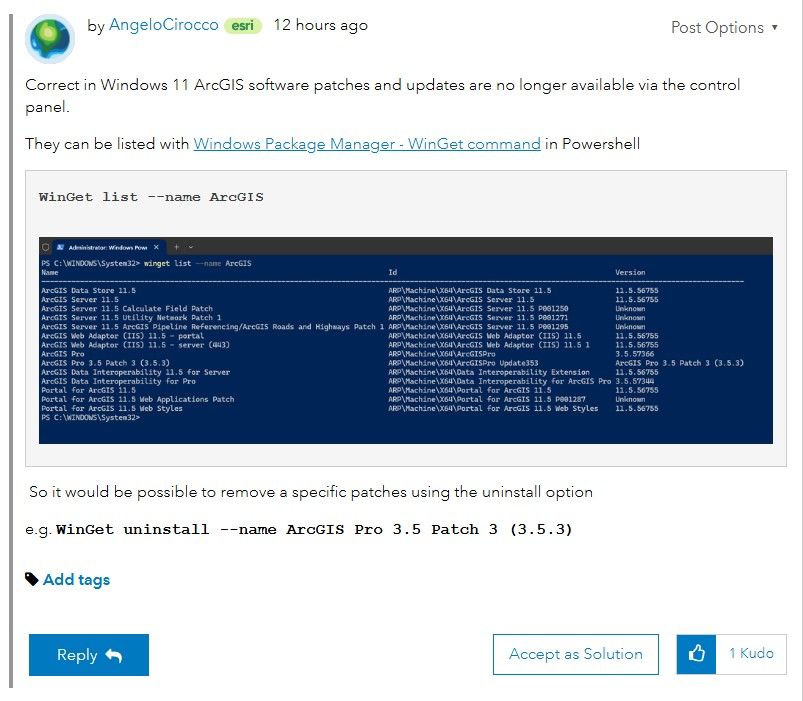

3.  If you're on Windows 10, you can uinstall services packs back to 3.5.0 for example.  To do so, go to Control Panel->Uninstall a program->(top left) View installed updates->then click the ArcGIS Pro Patch 4 (3.5.4) and uninstall.  This will remove the service pack back to ArcGIS Pro 3.5.3.  You can also uninstall 3, 2, and 1 service packs fully to 3.5.0.  Then retest your workflow.  Does the issue still persist?
4. If you're on Windows 11, Microsoft made it harder to do this.  See screen grab below for Windows 11.

I can try rolling back to 3.5.0 and see if that works, thanks. I tried the Powershell method above (WinGet uninstall --name ArcGIS Pro 3.5 Patch 4 (3.5.4)) but I get an error that the argument only works for single packages, and I don't really know enough about Powershell to go further. I can try a full uninstall and then reinstall 3.5.0 from My Esri
