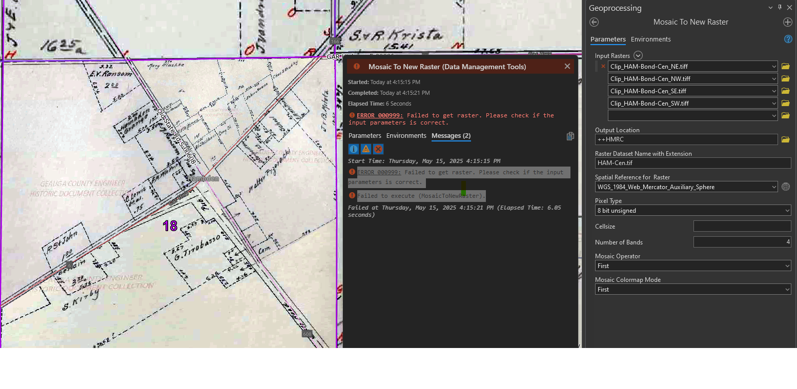

In ArcPro 3.4.0, I'm trying to use 'mosaic rasters' raster function, but I keep getting this error "Geometry cannot have z values" Using 'mosaic to new raster gives this error:
ERROR 000999: Failed to get raster. Please check if the input parameters is correct.
Failed to execute (MosaicToNewRaster).

Two things that I see that caught my attention:
1.  For your output location, you have ++HMRC.  The 2 ++'s may be causing the issue.  What happens if you define a path to a location on your C drive?
2.  Instead of creating a TIF file, what happens if you define it a file geodatabase raster dataset instead of a TIF?  Does the GP tool work?
