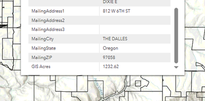

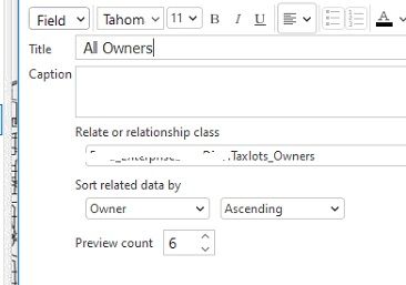

I have a related table that is showing up correctly in the pop up in ArcGIS Pro 3.5. However if I export it as a feature service to AGOL the table doesn't show up. If I export it to portal 10.9.1 neither the related table nor the hyperlink show up (but I think that is working as intended)

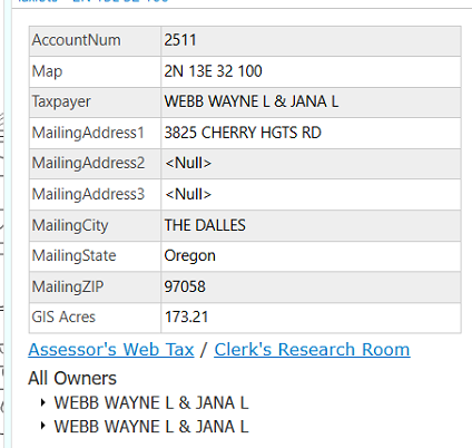

Pro pop up with arcade-created hyperlink and and "related records" choice:

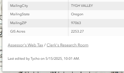

 Popup in AGOL (has hyperlink, missing related table):
Spoiler

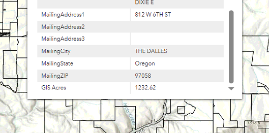

In Portal 10.9.1, missing both (but no Arcade support, correct?):
Spoiler
Any ideas out there? Long-term it needs to work in enterprise 11 (which of course I can't test). I'd like to have AGOL up as a workaround/backup until then
