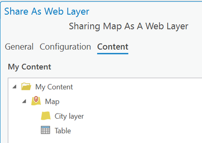

Hello,
After evaluating this idea, we have decided not to make any changes to the current behavior or documentation. To share related tables with the web layer, use the commands on the Share ribbon: Share tab > Share As group > Publish Web Layer. In the Share As Web Layer pane, under the Content tab, you'll see the tables that will be published.
Users who don't want to include the related tables in the web layer can share the selected layer(s) only by right-clicking the individual layer in the Contents Pane > Share as web layer.
