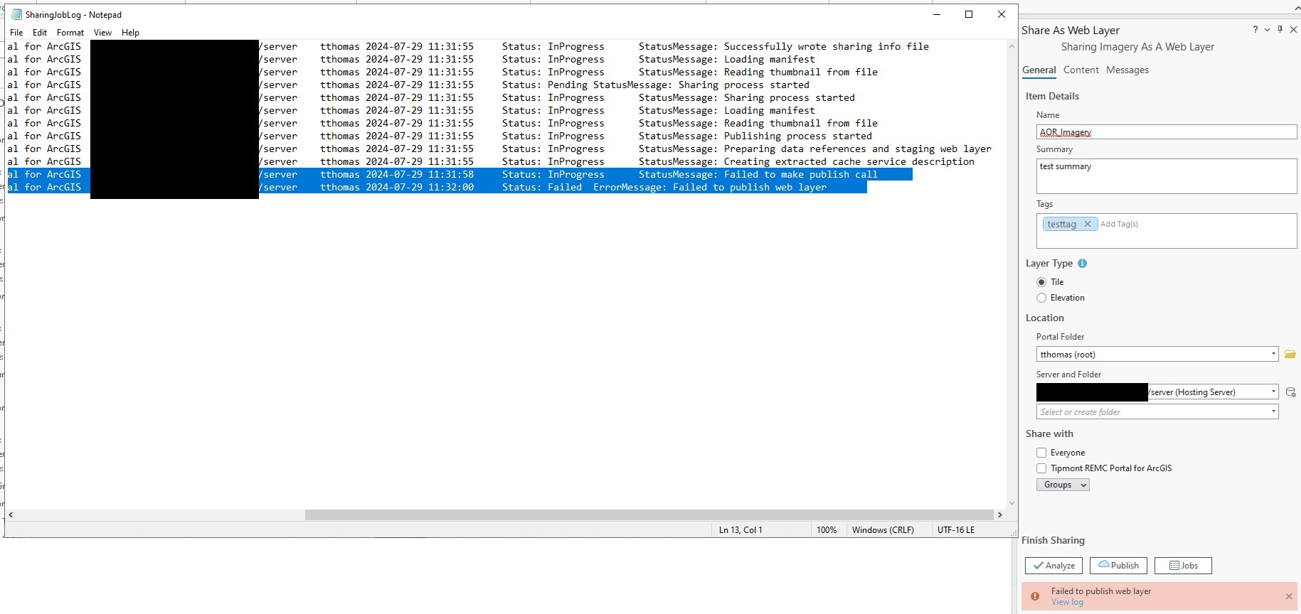

I have my .tiles file in a registered folder. When I Right-Click the .tiles file and hit 'Share as Web Layer', the Analyze pane shows no errors. However, when I hit Publish, i get an error saying "Failed to publish web layer".
Looking at the log, seems like the error is that it "Failed to make publish call" ? Not a lot came up when I Googled this. I also opened the log using Ctrl+Alt+M but did not see any errors in there.

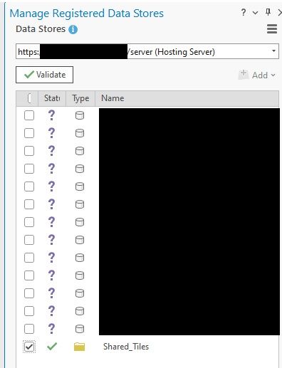

I am not entirely sure what this means or how to address it. I validated the folder the .tiles file resides in and ensured it was on a Hosting Server:

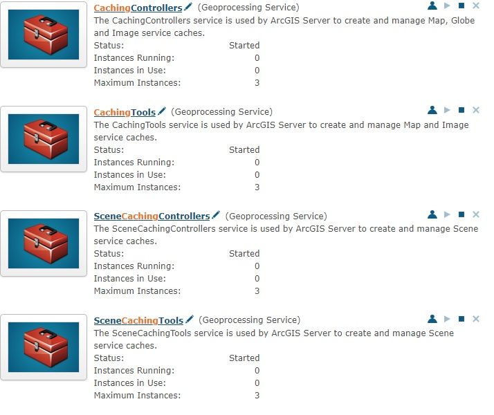

I also ensured that our caching tools were Started, and then restarted them just to be sure.
